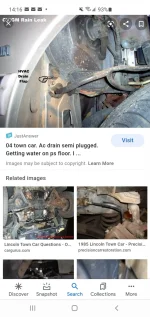

2005 Town Car. This is looking at the engine side of the passenger firewall. I have resealed the cowl fresh air inlet to stop the usual water leak. I also tightened the nuts that hold the black fan and evap housing. I have seen water coming out the bottom of the evap housing with the A/C on. Where does the red circled drain come from and should that have water coming out of it as well during normal A/C use?
I posted this before somewhere but here it is again. I've been dealing with these cars for decades now. The drain will start a bad rust spot on the frame right where the a frame starts at frame corner. Right on side and top. My friend buys these cars and told me about this spot a long time ago. My 99 Cartier had this issue and I didn't know it. So either attach a hose around it so that the water drains off frame or reroute it however but if you don't it will rust out and it starts from inside so time you see it it's almost too late. I had to put a hose over top and get it draining off inside of frame and spot last and weld up and traet the rust with ospho and it was a bear to do. I never knew this until he showed me on my car. If you look on left side of passenger wheel while steering is turned to the left or right all the way you'll see a lil tiny spot looking back at you. It looks like nothing until you look on top of frame and realize it's rusting inside towards the outside. Hers what I did to can't and stop it from happening. Well worth the money. Works great and is easier than cutting, sandblasting and welding.
This is what I'm referring too. My car was a southern car so ac was on its whole life. It leaks down right on top and goes inside of frame and rots from inside out. Very bad design. Alot of these panther cars get junked because of this issue. If it's too late it's too expensive and then safety becomes an issue
