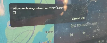

-Bonus! car-usb-handler appears to have been added (or fixed). AudioWagon retains access to the USB across restarts. @Sharbotcom
(AudioWagon is a USB media manager app available from the car's Play Store. It lets you use commands like "hey Google play artist Fleetwood Mac album Rumours" if you're already listening to AudioWagon/USB, or "hey Google play Wake of the Fluid on USB" if you're presently listening to SiriusXM.)
I had the update installed at the dealer and it still doesn't hold the permissions for AudioWagon.

@markfm can you please confirm update id of your last update. I want to confirm it with the dealer that it has the same ID as what was loaded on mine (by the dealer). Thanks.
This is what went in at midnight. Prior to this APIM flash AudioWagon was 100% consistent in needing to have USB access (the checkbox thing) thanks on every restart.
Note: if you did have this update, it's always possible it was a bad flash, sometimes that happens without any obvious issue.
This is what went in at midnight. Prior to this APIM fish AudioWagon was 100% consistent in needing to have USB access (the checkbox thing) thanks on every restart.
Mine shows the same update release id but still no sticky permissions for AudioWagon. Thanks.
I tested it today and appeared to stick. Was the checkbook there before?
Everytime I start the car the checkbox asking for access appears (or, I have to go into the AudioWagon settings to force it to appear).
The checkbook i see is much smaller.
You should only have seen it once to set it and never again if it working right.
I no longer get the AudioWagon USB access pop-up on starting the vehicle. I'll check again tomorrow.

As of Friday, AudioWagon permissions were sticking throughout the day, I didn't have to keep giving it permissions on each car start, but no longer - back to requiring permissions.
For google maps navigation, changing the prompt volume during the response to a "Hey google, navigate to..." command (where it says "navigating to...") works, does persist, but it no longer gives the spoken directions. I went back in under the main Settings - Sound, to check, nothing obvious to change. It is navigating, the directions are showing on both the center and panoramic displays, just no audio directions :)
I'll play with it a bit more, but shrug...
Welp, one step forward, then two back...
Well, it appears, that the permissio will stick - albeit temporarily. I noticed if I don't lock the car and come back to the car before the system shuts down (5 minutes or so), it will keep the session alive, and therefore the permission. Beyond that, it looses the permission setting. So perhaps you were experiencing some.of this behavior.
