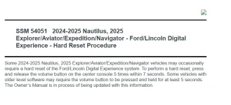

It is the new 5x in 7 secs method to reboot
I'm reading this as you push the large center knob 5 times in 7 seconds to reboot. Is that correct? How did you figure this out?
One of the TSBs mentioned this as an alternate way to reboot. It seemed at first to be mentioned as a method for other vehicles, but it would appear we have adopted some of their code.
This was the TSB that announced the reset (reboot) change. It just took a while for Lincoln to roll out the code to field. After the OTA update the old method does not work.
