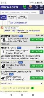

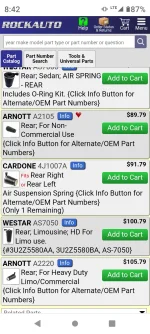

Compressors are about $290 shipped, bags are about $100 a piece shipped, that's going with Arnott on RockAuto
Got them for way less then that on the sites I mentioned.
Those are mostly the Chinesium no name ones on eBay that are much cheaper, consensus has it that they will only last a year or 2 ?? I was quoting RockAuto prices with Arnott as the manufacturer.

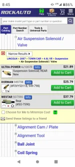

This is for your 07 Town Car, prices shown are without shipping.....
With shipping you're looking at well over $400.00 , whatever you choose, good luck.
