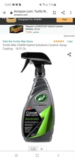

Walmart, autozone, amazon. Its 14.99. You can Google it but it's a ceramic coating that's not $60-80. Just spray 2 sprays per panel and wipe and buff with microfiber cloth. So far it's amazing like the 303. BTW if you get new tires before you put on car spray that 303 all over inside and out and your tires will not crack, rot or look bad ever. Same with any rubber pieces. The video was on project farm about the hybrid solutions. He sprayed on a hood along with other like products and tried everything to get it to fail. Degreaser, dish soap, brake cleaner. Still did a great job. I use it on glass, leather seats after treating with meguiers leather wipes to keep them clean, soft and spotless. So far it's great. You'll thank me after you use it and see for yourself!! I can promise you that!

It’s called turtle wax hybrid?
