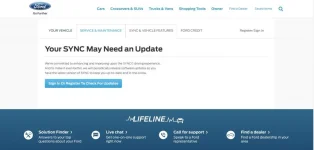

That is not the page I linked to. However, try the 'Sync' bottom right. This is:
This is getting rediculious!! I click on the link you provided and it takes me to the page I show pictured. I click on the sync link on that page and it takes me to the Sync 3 page. Sync3 isn't going to help us much.
Then if I click on the customer support link on that page it wraps me right back around to the original page I have pictured.
Ford's web sites suck!
I guess I'm doomed. That link takes straight to the page I pictured earlier. :mad:
Something is wrong with your PC. Here's what I linked to this time:
