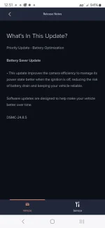

Got this update today.
Funny that I drove 15 miles before the update. The battery went from 60% to 85%. Got the update prompt and I allowed it to install. After that I drove back home (15 miles) and when I got there the battery was down to 60%.
Interesting that it says: "This update improves the camera efficiency to manage its power state better when the ignition is off". How is the camera used when the ignition is off?
Hi Fuzzy John. There are modules/circuits which stay active for a programmed amount of time after ignition off. Some for 10 minutes, some for 30 minutes etc.
The issue in some vehicles is that certain modules/circuits are not shutting down properly/as designed after the ignition is turned off. Or after those programmed time limits.
Lincoln/Ford is attempting to address these issues via software updates.
