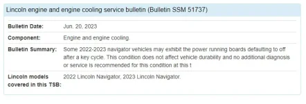

Two manufacturer communications regarding the running board getting set to off were published with NHTSA back in June. Numbers SSM 51714 and SSM 51737. It basically says they are aware of the issue but no fix is currently available. Advises dealers to monitor for when a fix is available.
Thank you. Do you have the official link to this? Mine almost crushed my feet when I was standing on them and they retracted!

Here it is:
Scroll down to the Manufacturer Communication section. They are the ones dated June 14 and June 20.
Thank you! This is a huge issue. I am disabled and I have a 3 year old. Without the running boards i and she cannot enter the car. Also twice once when I was on them and my daughter was on them they retracted without warning! We both fell and luckily didn’t hurt ourselves too badly.
