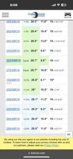

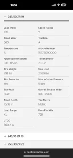

I have 225/55R 19. Continentals don’t come in that size. However the size above or below is almost identical so I would chose one of them
I would go with this in my case. Basically the same size hight wise and about one inch wider which would probably be better. Also falls within recommended rim size spec
