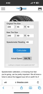

You are correct ! However the stock tire is 28.7 in height and the one I would put in is 28.6 so one tenth would not really matter
702 revolutions per minute as opposed to 704 revolutions per minute. So is there a setting in forescan because you can have the same model car with 17,19,20 inch tires etc etc

Here is the exact difference. Close enough for me to have the continentals

I like the tiresize.com information.

Yes 245 is the one I did the comparison on tire size .com. Approved for 7-8.5 inch rim take a look back at that pic. That would give me the Continentals I always use with no real difference in speedometer (a teeny bit lol) and a little wider which might be better. But here’s an important thing for the snow. Wider is not better. Take a butter knife. Turn it sideways try to cut through the butter. It won’t go. Now straight up and down it goes through. I used to do snow plowing with my brother. We used an F-150 with the skinniest tires we could put on it and never got stuck. Skinnier tires in the snow cut through to the pavement. Wider tires sit on top and spin. Just a little not for people that put super wide tires on their cars or trucks

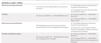

Premiers come with 19 base, 20 inch option
Reserve comes with 21 base, 22 option
Black Label with 22
