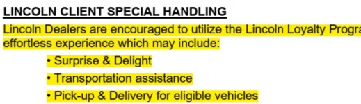

In the Canadian notice, I like the words "Surprise and Delight".
