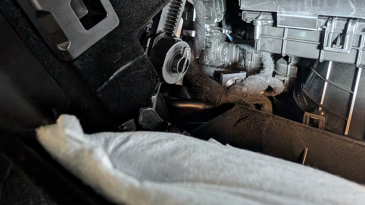

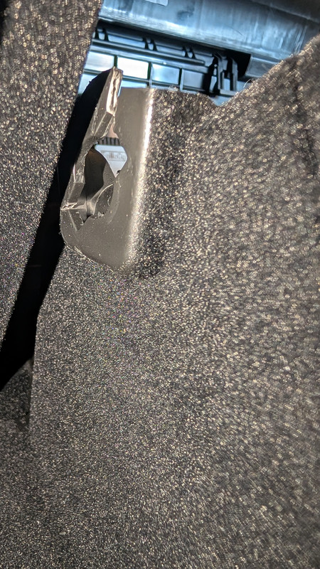

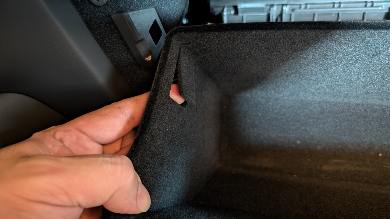

You can refer to Vin's write up, see post #12...pics included!Here you go Steve. 9 pictures so I converted them all to small jpegs so I hope I can put them all on one posting.

The glide fits into the hole on the side and once you depress the dog ears to let the door open, the glide is holding it from flopping in your lap.
Get your fingers behind the circular portion and push it up and it will move to the bigger opening and you just pop the glide out.

1 glovebox
2 these dog ears are on both sides and must be pushed in at the same time. The door will drop a little more.
3 is the glide arm that can come all they way out if you don’t disconnect it from the side when you’re a goober figuring it out the first time
4 is the big hole/small hole the glide snaps into.
5 is the door lying in your lap and the massive space to work inYou can see the air box cover.
6 is the cover off and the clip for the left side.
7 are the screw hole on the right
8 is the glide are where it stays when your not a goober and pop it off the big hole/small hole properly.
