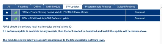

Super happy to hear the GWM update took! AG is great, hopefully they push out AG 1.2 ASAP!! Noticed they did not perform the APIM update, hopefully you get that via OTA soon. That enables full screen Apple CarPlay and some other behind the scenes things you don't notice.

One thought, I still have my FDRS license active for another 21 days. If you want I can run your VIN and screen shot any updates that may or may not be there. Will give you an idea of exactly what the dealer will see when the plug into your OBDII port. Just let me know if you want me to do that. Just want to help get the AG back for you.
