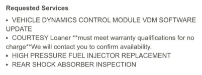

Someone on FB already has asked for the VDM fix by their dealer (they were dropping off their hybrid today for shocks and injectors):

Ford just issued a fix for battery drain on 24 Nautilus on vehicles butlt prior to Apr 26 2024. Re program a module which is keeping the CAN bus active, 12v battery drain. Consult your dealers.
There are 3 CSP's for the 2024 Nautilus according to my dealer's service advisor. One (CSP 24P14) covers the battery issue. Affects units built thru April 26th. Dealer has to reprogram VDM module. Around 12,600 vehicles are affected. The other 2 cover faulty high pressure fuel injectors and a loose rear shock issue. I don't know the details on them. You would have to contact your dealer and find out more. All in all, this has been a rocky launch for the 2024 Nautilus. My dealer has had 40 units sitting on his lot for nearly 2 months now and these ongoing service issues are certainly not helping sales.
