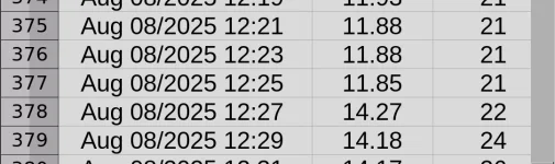

Today we went in, supposed to be done. Turns out they missed one thing but it gave me a chance to check battery state. It was showing 11.85V, 21% SOC.
I let the shop know they really need to put it on a charger (probably had the driver door open for an extended time working on it).
As this is the collision center for our local Lincoln dealer I'll share the data with their Service department when I bring it to standard Service (normal SW stuff). 11.85V is pretty low to let it drain to.

Staying on topic, 12V battery showed 11.9V, clearly not up to snuff given I had told them multiple times that it's a hybrid, that the 12V needs a charger when they're doing things with doors open for hours. Back on 4 August, original drop-off, one of the workers had said they would "try" to get it on a charger, but didn't have enough of them; Manager called BS on his own people, specifically said he had bought multiple additional chargers just for these activities.
Manager said they had put it on a charger, got it to 85% SOC. I showed him the voltage chart for the last 3 days, obvious that they didn't really do a significant charge cycle.
I let the Manager know that I had reached out by email, documenting that the vehicle was down at 11.85V last week, and that seeing it only at 11.9V today was not a good sign, requested that he have his smart electrical person do a battery check, and pull in Lincoln Service if needed (the main Lincoln sales/service place is in the same building).
