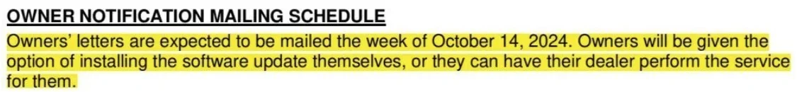

You'll apparently have the option to do it as an OTA:

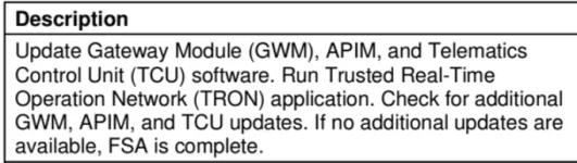

It sounds like multiple items are being touched in this update. The reference in the CSP for dealers to use the TRON tool, checking for additional updates, sounds like there's a chance things may not play well together if everything isn't brought up to latest firmware.

The 3 standalone CSP were for reprogramming of different modules than are listed for 54. I wouldn't be surprised if they took a look for any unintended APIM/GWM/TCU drains in coming up with the 54 CSP.
