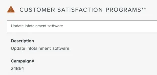

I just noticed a new CSP in my dashboard on line, 24B54 update infotainment system. I have not check my vehicle yet. Is this perhaps the 3Q update we have been waiting for.

I see it too. It was not there earlier this morning. Haz has not posted anything yet either. He usually posts the details.
I don’t see anything in the Lincoln Way app, isn’t there supposed to be a notification there?
I'm seeing it in my online account on the 'Recalls' page of the Owner Dashboard. Historically the Lincoln Way app hasn't shown TSP/CSPs, only recalls.
