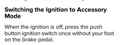

On my Nautilus, If I press the "start/on" button without pressing the brake, the vehicle goes into "Full Accessory" and there is a message stating that. Everytthing seems to full on (AC blower, etc) but READY does not illuminate. I have never seen a need to press a button twice. I interpet the instructions for BMS reset is that it is full accessory mode.
Manual
With the foot on the brake the ready light appears so vehicle is ready for drive.
I can turn on the radio without doing anything by pushing the round knob but suspect the fob must be present.
Then there is the mode where features (like radio) operate after turned off until a door is opened. This is when I can push the knob and radio comes back on. I do not know how long/
Manual

I am not sure why you say it is my preference. I was discussing putting it in accessory mode (Lincoln calls it Full Accessory Mode) in order to reset the BMS since there is no key. I would not leave it that position. It is usually needed though to play with infotainment if you do not want to start the vehicle.
"for those of us who have that need, pressing the Start button twice with our foot off the brake avoids unnecessary battery drain.". This is the normal mode after completing a drive and you can listen to radio so usually encountered in normal drive. \
With my Nautilus, you do not need to push the button twice to turn on radio. It will come on when you push the center knob so no need for the 2 push step. Unlike the end of drive accessory mode, it does NOT turn off when you open the door but have not determined how long it would stay on. I suspect it will go off if you exit and take fob with you. I will test that later.
Way too often, I use the radio-only mode when I sit in the car and wait for my wife to get back from the store. It's the only time I get to turn it up. 🔊🫨
(Presuming the temperature is moderate, else I run the vehicle.)
