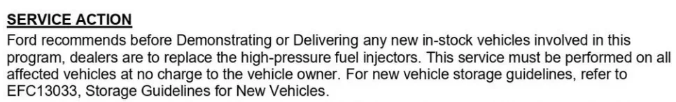

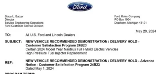

The May 20 formal bulletin, while only "recommending" (since it isn't a safety issue), is quite clear:
I absolutely understand that not all people would be aware of this, but by now for sales staff to still be ignorant on this topic (management not sharing important information), and managers to brush off concerns, is truly unacceptable behavior.
I've also heard reports of customer-focused dealers, segregating the vehicles flagged for the fix, letting buyers know of this problem before sale, so the buyer could delay closing until their vehicle was repaired ( or getting a new in-transit vehicle that doesn't have the problem).

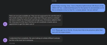

Doesn't sound like my dealer has the parts, based on what I was told this morning. See text conversation below.I suspect the failure rate is fairly small and occurs generally within the first few hundred miles (outliers do exist). The primary cost is the injectors themselves. They are around $50 each retail and take about 30 mins to replace all 4(maybe 1 hour shop time) and can be done in the parking lot really. From what we can see Ford has already distributed parts to dealers.
I'm sure each dealer will have different expected arrival dates for parts but they are all supposed to have enough parts to cover vehicles sold and on lot. The parts are not available in the system to be ordered. After i received a similar response from my dealer, i responded with the labor allowances and parts ordering information from ford and suddenly "parts arrived today".Doesn't sound like my dealer has the parts, based on what I was told this morning. See text conversation below.
Where did you get this info? Can you share it?i responded with the labor allowances and parts ordering information from ford and suddenly "parts arrived today".
Exactly. Please share. Thank you.Where did you get this info? Can you share it?
