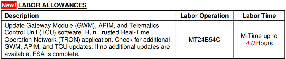

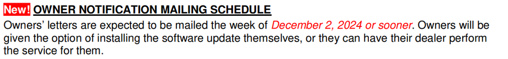

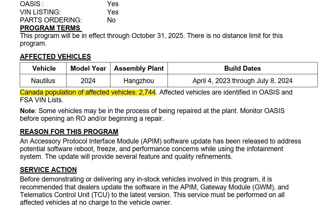

Ford has issued CSB 24B54 Supplement #1 to Dealers, with a revised date for Owner Letter mailing...
...increases the allowable Labor Time to conduct the Service Procedure...
...and revises the Service Procedure to improve the programming success rate.
The updated Service Procedure with revised instructions shown in red text, formulated for dealership professional technicians using the Ford Diagnosis and Repair System (FDRS) to perform the software updates, is attached below as a PDF document...
Owners who opt to perform the software updates on their own, will use the Over The Air (OTA) automatic download and installation method.
In Canada, the only Supplement #1 difference is Canadian Owner Letters are expected to be mailed by mid-December 2024.
