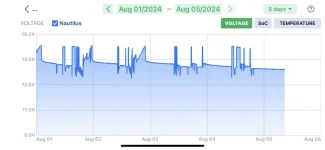

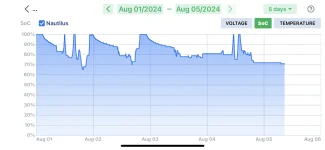

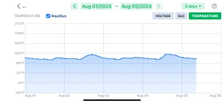

unable to perform 24P14. Shortly after, I purchased and began using a NOCO Genius10 (shout out to swindler and angore for install guidance). I then purchased and began using on July 31st an Antigravity Battery Tracker Plus (seems identical User Interface as the Ancel BM300 Pro mentioned by others here). FYI...Before the 31st and thru today, August 5th, I disabled the Approach Lighting, Phones as a Key, and kept the fobs in a Faraday pouch until driving car. I am attaching screen shots of the Tracker's History of
Voltage, SoC (State of Charge) and Temperature from August 1st thru early morning today, the 5th.
Here's some detail of the chronology.
The State of Charge graph is one of the easier ones to understand charging and the Voltage graph driving and charging.
August 1st
Plugged NOCO in late on July 31st...battery quickly went to 100% then began stair-stepping down to 89%
at 8:30am when I unplugged the charger. It then down to 83% on it's own.
My wife then started the car at 11am and you see the first spike to 100% during a very short drive, then a drop to 79%, then 77%.
She started the car for a little longer drive at 1:20pm causing another spike to 100% while driving, then down to 76%.
She then drove a very short time home, it spiked to 84% then down to 66%.
I plugged the NOCO in around 8pm and you see the first stair-step to 68%, then 79%, then 100% at 10:30pm.
August 2nd
Battery began stepping down at just after midnight to 79%
at 10am and I unplugged the NOCO.
We then went on a few very short drives while I monitored the Tracker real-time (see Voltage spikes) at came home
at 4:30pm and I plugged the NOCO charger in at 73%.
It climbed to 86% at 6:45pm, then 100% at 7:45pm until 10:30pm when it began stepping down.
August 3rd
It continued down to 86% when
I unplugged the NOCO at 10:15am and went on a number of short trips throughout the day and evening.
I did NOT plug the NOCO in anytime the balance of the day.
August 4th
I did NOT plug the NOCO in at anytime throughout the day. What you see on the SoC and Voltage charts are driving trips during the day.
August 5th
No NOCO and no driving as of the time of the charts.

I am going to see just how far down the SoC and Voltage trends proceed from today without using the NOCO charger. As a note, when I first hooked up the Tracker on July 31st, it read 64% with a Warning of Low and the Charge Soon.

BTW...I live in Southern California and it's been very hot...see Temp chart.
