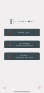

One note here. I have a 2018 with factory RSE. I have had both screens and the coax cable replaced, and I still have intermittent issues. EVERYTIME my passenger/slave display doesn’t work, you can turn it on and control the display with the Lincoln Play app. It doesn’t solve the greater problems, but using that app has saved me from pulling over, moving the passenger seat forward, and restarting the vehicle. I have no idea how or why the app can control it when the buttons that are physically installed cannot, but it works.
I thought the Lincoln Play App was discontinued? I had to get a separate tablet for content with a HDMI to run to the drivers side monitor.
I think the app is discontinued. I have a 2019 reserve L with the same problem passenger monitor not powering on.

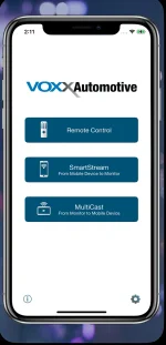

Not sure if this helps, but the screens are made by Audiovox (VOXX). They still have an app that has the same controls as the Lincoln Play app.
The connector is certainly the issue. I am still try to find a good solution for using the monitors without a useful app. I tried connecting a phone or tablet thru the hdmi but it doesn't just duplicate or project the screen. Very frustrating.
I confirmed this VOXX-RSI works to control the RSE in my 2018 Navigator.
