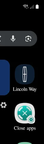

Pretty sure I mentioned it here, but for those of us using Android phones there's a cool app called KillApps on Play Store.
It's very easy to create a custom list of apps you would like to force stop with a single button tap, with a widget available that you can place on your phone desktop (Close apps).
My full custom list includes other apps, but Lincoln Way and BM300 were my original two - Lincoln Way because I do use PAAK, and closing Lincoln Way turns off PAAK, and BM300 because the app doesn't cleanly reconnect for me if I've gone out of BT range after previously connecting.)
