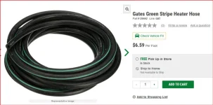

If you want some good heater hose have O'Reilly's bring in some Gates Green Stripe heater hose. Don't let them try to sell you Safety Stripe, like they did me. Green Stripe is more than twice the price of Safety Stripe at $6.59 per foot for 3/4".

I asked about the Gates Green Stripe hose and they told me they have to put in a CSR for it and will let me know in a few days if they can get it, and if so, how much it will be.
The green stripe is only needed if you are keeping the Navigator for a long time and don't want to redo the hoses and want the best. That's funny they don't know the price, it's right there on their website.
@Indy Thanks. O’Reilly told me today they can’t get the 3/4” Gates Green Stripe as it is back ordered. They can get the 5/8” in a day. I’m not sure about the quick disconnect. The ones you show are the ones I ordered to make up the heater core return hose assembly (the one without the heater valve in it). I actually found the OEM Motorcraft hose assembly for the heater core inlet and ordered it from Amazon. I found out that the parts that Ford shows for my VIN aren’t accurate. I found the OEM lower radiator hose assembly from Walmart online of all places and a Gates hose for the upper radiator hose on Amazon. I am waiting on those to arrive. I think I found the correct OEM hose that goes from the bottom of the expansion tank to the engine. It came in today from Amazon. According to the Gates part conversion site the heater hoses are actually 5/8” inside diameter instead of 3/4”. If so, the quick disconnects I would need are probably the ones that are 5/8” on both ends. If so, I ordered the wrong ones. I ordered a disconnect tool which arrived today so I’m going to try to get the old assemblies off so I will know for sure the internal hose sizes and quick disconnect end sizes. Odd that Ford would show the wrong parts. My vehicle was built in 08/2003 which looks like when there were parts that were changing over, but even when I shift the mode year they didn’t match up. It took a lot of searching and visual comparison of images to hopefully get the correct ones ordered.

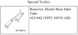

@Indy I found a video on YouTube where someone was demonstrating a tool they made to remove the quick disconnects for Ford heater hose connections. Someone commented and said part F65Z-18472-BBC (Motorcraft KH735 I believe) fit most 5.4L engines. That is a quick disconnect with a hose attached via a spring clamp. I was trying to see if the disconnect was available separately. I did find the full assembly available on Ford part sites and about half that price on Amazon at this link:
Amazon Motorcraft KH735
I would love to be able to buy just the quick disconnect that is used in this hose. Does anyone know if the quick disconnect itself can be purchased separately from Ford for assemblies where a spring clamp was being used to attach the heater hose instead of the crimp connector? it looks like the Dorman part I orders as long as it is the same size. However, on the Ford site someone asked about the inside diameter, presumably of the bare hose end instead of the quick disconnect and they said about 5/8". So, if the that is true then I would need 5/8" ID heater hose instead of 3/4" ID which is different from what most people indicate they end up using. That would also mean I need a 5/8" x 5/8" x 5/8" tee. I did find Dorman part at O'Reilly's that is 5/8" on the quick disconnect end (to go over the heater core tube) and 5/8" (presumably OD) on the end the heater hose would go over top of.
I didn't get a chance to work on it at all today, but am going to try to get the hose off so I can check the hose and connector inside diameters tomorrow.
Ted
Does anyone know the part number of the tool Ford uses to release the heater hose quick disconnects on a 2004 Lincoln Navigator? I ordered OEMTOOLS 27106 from Amazon which is supposed to work on 5/8" and 3/4" quick disconnects, but even the 5/8" end of the tool seems to be too big to fully depress the tabs on the heater hose quick disconnects at both the heater core ends and the auxiliary heat connections going to the back of the vehicle. I have tried to release them with my hands and even tried a 17mm open end wrench as I saw someone had success with, but I have had no luck getting these things to release.
PN 47164 and 800-404 are both listed as fitting the 2004 Navigator, but just maybe one of the others is what you are looking for.
When I did some further checking under the hood, I measured two different size hoses. So I must have used both 5/8" and 3/4" heater hose.
Have you tried pushing the hose on first while depressing the tabs, then pull it off. Pushing on first might help to disengage the taps.
The one I ordered from NAPA is Balkamp Part # BK 7769140. The OEMTOOLS 27106 Heater Hose Disconnect Tool that I ordered from Amazon was supposed to work on 5/8" and 3/4" quick disconnects. The 5/8" end of the tool has an opening that is 13/16" across and the 3/4" end of the tool has a 1 1/8" opening. Both of those seemed too big to depress the tabs in the slots in the sides of the connector.
Thanks for checking on your hoses. I did try pushing in on the hose while I tried to slip the tool up over the tabs in the connector. It just didn't feel (or look like the tabs were getting depressed enough. The one that actually caused the leak broke off right where the metal crimp at the end of the rubber tube went over the end of the quick disconnect, so it will be a nightmare to reach to try to push on it. If I can get the return hose loose first I may have a chance.
I'm heading to pickup the tool now. I'll let you know if it appears any different and if it does if I have better results.

Well, I finally got those heater hose assemblies off, but it was not by any help from the OEMTOOLS 27106 or the NAPA Balkamp/Evercraft 776-9140. I messed with the remain "not-quick" disconnect connections until I ended up breaking the plastic fittings into where they went into the hoses. Once those were out of the way, I could get enough inward pressure on the remaining fitting to use my fingers to squeeze in on the flanges that extend out the quick connect end of the fitting and get the tabs to release enough to wiggle and pull the rest of the fitting off. That left the inner ring and 2 o-rings sandwiched around a plastic washer still on the metal lines. I bent the flanges back toward the end of the metal lines and as I did that they slid off.
Once I had them off, it looks like the inner diameter of the heater hoses is actually 3/4", but the quick disconnect is definitely not that big. It looks like maybe the quick disconnect needs to be able to fit on a 5/8" metal line with a flange and the plastic male end needs to be able to go snugly into a 3/4" ID heater hose. That means the Dorman 800-404 quick disconnects I ordered are incorrect as they are made to go on a 3/4" tube and into a 5/8" hose. I am pretty certain I need exactly the opposite.
