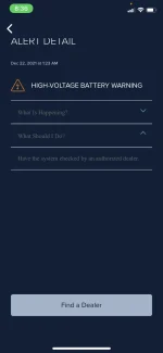

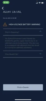

My wife has 2022 Aviator GT with 3,000 miles on. I bought it on 12/22 in Alabama. I drove it to KY the first day I had it. On the drive the battery never charged. Read 0 miles electric the whole drive, which I find odd.
The first time my wife got in the car she got the “full accessory power message” with a No-start, 545 miles on dash. No other messages. The car wouldn’t go into gear. It said it detected a fault in hybrid battery system. After 30mins the car started up without issue with no codes. (We googled the message and found another Ford forum that said let the car sit)
Local dealership took 3 weeks to get it in the shop. They said nothing was wrong and everything was up to date. Even though the vehicle said it detected a problem with the hybrid system. Week of Feb 1st.
Last Wednesday, while driving 70mph on the interstate the car turned off. Wife said if felt like someone turned the ignition off. Gas pedal was dead and she had to coast to a stop. The car popped up “Stop Safely Now” and “full accessory power” and would not restart. She waited 30mins again, like before, and still nothing. She tried the start button to no avail, tried to remote start it with the key (nothing). Car restarted with the phone as key app though. No messages showed after finally restarting.
Took the car back to Lincoln and they said they can’t find anything. They’ve had it a week and put 100 miles on it. The service manager took it home over the weekend as well.
I have filed complaints with the NHTSA and Lincoln.
Anybody else dealing with these issues and does anybody have a fix for it. This thing is a death trap.

View attachment 12631View attachment 12626View attachment 12627
