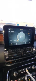

And just like that my car connected to my internet at my house, updated and my temperature gauge is now fixed... 🤦🏻‍♂️ go figure20211204_153035.webp
Interesting you don't have the temp showing at the top corners of the screen.
That is odd that things like that are not on every vehicle.
I‘ve go the same issue, never had the temp showing in the upper corners. That was what made it missing from the center so frustrating. At leas this new update restored the temp in the center.
