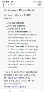

I have the same issues and I believe it is because of the update to 22251. I've done many "soft" updates, but don't clear problem. I have an appointment. at dealer on Tuesday. I'll post results on Tuesday.
Remember, there is a system reset and then a master reset that you can do.
I think the system reset is holding the power and right seek buttons simultaneously for 10 seconds. Yes?
They don't help. Most of the issues persist or come back after a few trips.
Yes, but Master reset apparently does more. See attached pic above to do Master.
