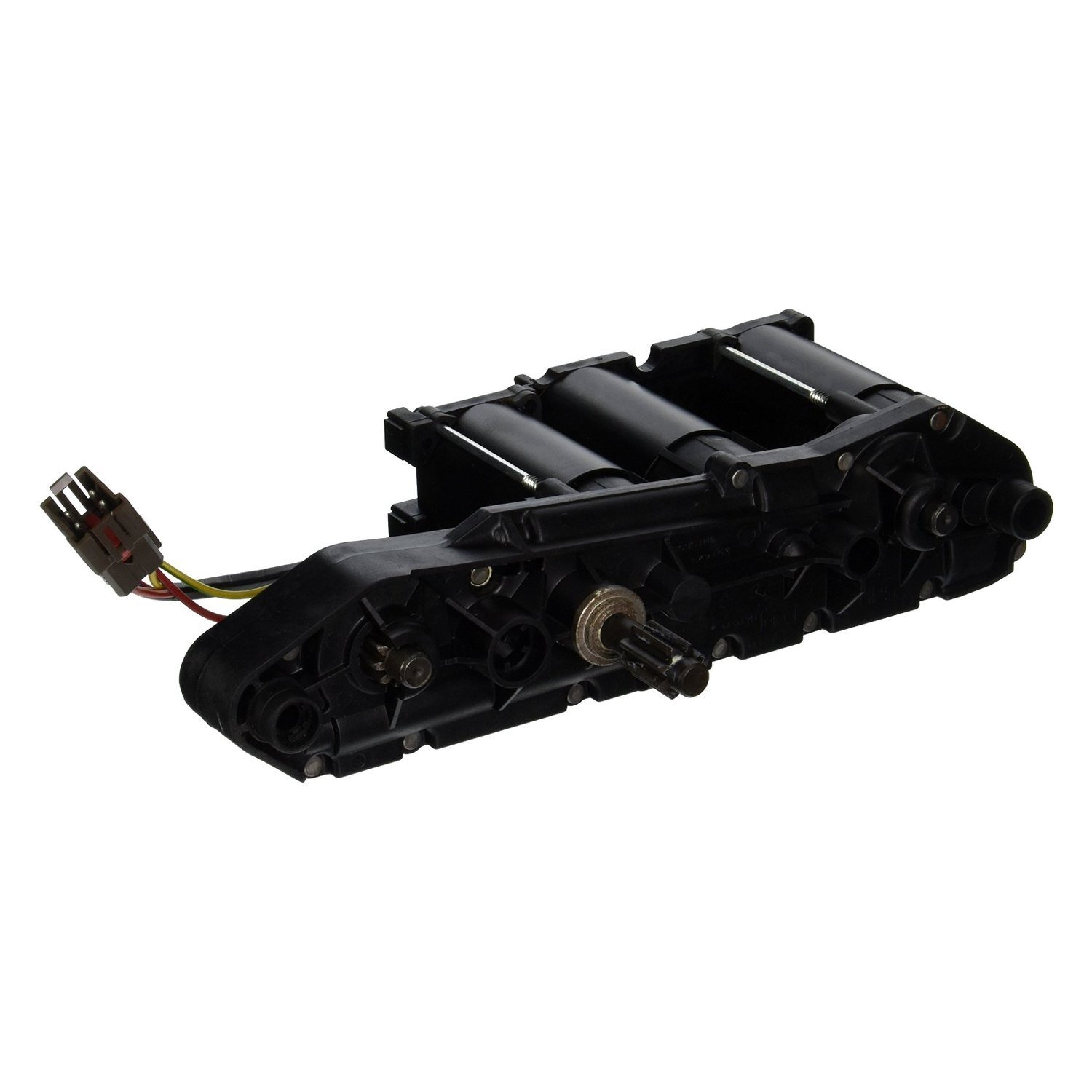

I just bought a 2001 Lincoln town car cartier. The driver seat doesn't move forward or backwords just clicks. I have called Ford/Lincoln dealer ship and the part is discontinued and have searched the internet about 4 hrs. local junk yards dont have any either. The Part number is MM-950 with memory for the motor. found a whole seat in Vermont at a junk yard but they want 200.00 to ship it because Im in Illinois. Does anyone have any ideas? My wife is short and can't drive it lol

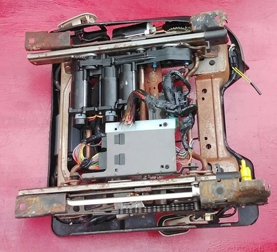

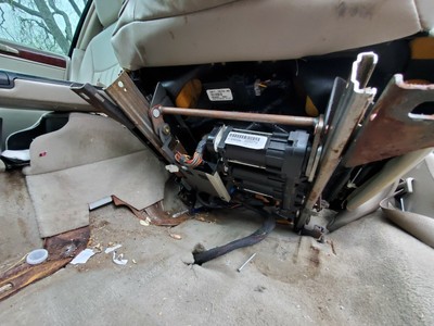

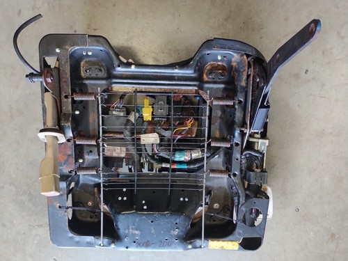

For about $300, you can get a seat with track and motor
$250 + $40 shipping
Seller states fits 2001 Town Car.
BTW if you add all of the other trim descriptions when you search, you will never find what you want. Just use 2001 Town Car and the part you want.
The part number of MM-950 may be a Motorcraft number or the junk yard number. It i not a Ford part number.
There are two others on ebay for more money.
Listed under seat track.
And Carid (and a bunch of other places, including Home Depot) has a motor assembly listed under MM950
Which IS a Motorcraft number

the motor from what im understand will only fit 01 and 02 03 and up wont work
