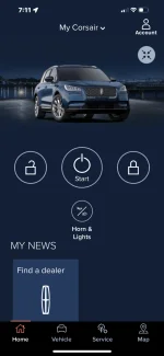

What I’m saying is to add the function of rolling the windows down in the app would cost them nothing. The core hardware is already there….having lte connection. It’s got nothing to do with Bluetooth antenna’s. It’s just has to be turned on in the app.
So look at what decided to show up to my app……Horn and lights.
I knew they could add that function for nothing. Now I’m curious if windows/trunk is coming.

Hi Steve. Locking/Unlocking and Horn & Lights has been a basic feature of the LincolnWay app since 2017-2018. So if those features were not in your LincolnWay app before, or until now, it was a glitch.

Hi, thanks for responding to my post. I had originally saw in this thread that the OP’s screen shot showed his app having all those features, so I posted a screen shot of my app only having the ability to remote start and lock/unlock through the app, and at the time asked if it was a Reserve thing only for those extra features. I thought maybe the same as you thought, glitch in the matrix, so I uninstalled the app, along with several new iOS updates, spanning official and beta’s. But the Lincoln Way app was updated yesterday on iOS, so I'm assuming it’s got something to do with that.
