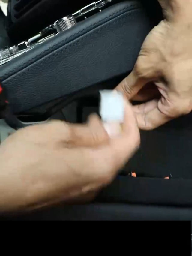

For my 2022 Nautilus Reserve, I found a device to automatically turn off the Stop/Start function when selecting D (Drive). FYI, selecting S (Sport) will automatically turn off the Stop/Start function.
I need some assistance with installing this device:
It installs in the A/C control unit on the console. The installation video for the device shows how to open the A/C control unit by removing the the panel underneath the unit. Alas, the shown control unit is in a Corsair.
The 2022 Nautilus' control unit is built into the console:
The back side of the control unit:
So my dilemma is how to open the control unit to access the connections to add in the eliminator device.
For the record there is also another that achieves the same change of function, the 4Dtech Nautilus Start/Stop Eliminator.
Installation video:
The first problem is it's $100 verses $40 the one above.
The second problem is it installs behind the passenger inside rear panel which the video shows it being pulled away from side wall. What the video doesn't show is how the original module's connector is disconnected and replaced by the new one (3' 20" to 4'0" in the video). Apparently that is the most difficult step. One comment suggested the panel should be completely removed to access to original module which makes the disconnection and reconnection much easier.
These two problems make me prefer the above device.
Any assistance will be much appreciated. :cool:
