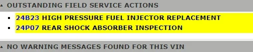

I would not trust it. Ours blew up at 2300, have had it 6 weeks. This is what it says for my Vin... Little bit late.

BTW, I do not see a shock absorber report for my vehicle.

Do you see this in your Customer Satisfaction Program list for your car? It’s not on mine, but it should be no?
No, it is not listed on mine. Just 24B09 and 24B23. Surely I'm one of the 6,686? For what it's worth, the issue is very hard for us to notice. Had I not known the issue existed, I may have never noticed it.
