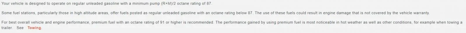

Hi WKDANI. All you need to use is the recommended 87 octane minimum. You can use 89, 91, 93 octane and will recieve correspondingly slightly higher engine power output. The full engine HP/torque rating is obtained in testing using 93 octane. Using 87 octane will result in a net loss of perhaps 5%-7% HP/torque. Unless you normally drive your vehicle hard, it is essentially unnoticeable.
Premium fuel will give negligible to no improvements in MPG's. And any improvement in MPG's is more than offset by the additional cost of the premium fuel. So the benefit of using regular/87 octane is it keeps more money in your pocket per mile.
Yes, there are those who will tell their own anecdotal stories of how much premium fuel improves their MPG's...However, scientifically controlled studies, the fuel companies themselves, etc, all prove that to be wishful thinking.
So...if you want to keep more money in your pocket per mile, use regular fuel. If you absolutely must feel the most power from your vehicle, use premium.
