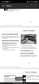

The '24 WSM matches what Tammie/Jason posted on Facebook. Then again, Jason is a Lincoln service manager, so it's likely he also went based on the WSM.
(if there was an "easy" way, though, he probably would have known it and showed that method)
The photo below is one that I annotated from the original photos by Tammie/Jason; it clearly indicates the GC was fully removed to get access to the CAF. It is also consistent with the Fang D. FB post, the one @angore posted a screenshot of in post 29 of this thread; Fang's step one is popping off the right trim panel (with the airbag symbol), and step 4 is where they show the location of the 6th T20 screw, the one on a little flange sticking out from the lower right corner of the box, holding the overall GC assembly.
I fully expect that what I wrote applies equally to the 24 - 26 Nautilus'. I don't see Lincoln coming out and changing the glove compartment mid-generation.
