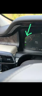

Hi, how do you mean when you say it shows the trailer is disconnecd ? do you get the message saying trailer disconencted or you are talking about the little green trailer light on the instrument cluster?
To answer your question, other than the running light issue, everything else seems okay.
Thank you. Yes, I got the message saying trailer disconencted/connected every time I use brakes.
Thank you. Yes, I got the message saying trailer disconnected/connected every time I use brakes.
Okay.. no, I dont have such issue.
I thought you were referring to this light, which for some reason I have only seen coming "ON" once that too for like 5 secs. I have travelled almost 900-1100 kilometers with the trailer attached in 5-6 trips.1000051870.webp
