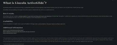

Yeah, there may be a sequence of steps to activate it properly... I'm guessing those steps have not been followed yet. Just looking at the Lincoln website, there are no disclaimers saying it's not available. Rather, it says it comes standard with Black Label Trim. It also says it requires Lincoln Connect activation (probably one of a number of prerequisite requirements).

Here's a link to a Lincoln site that says it's required: "Requires Lincoln Connect activation through the Lincoln Way® App (see Lincoln Way Terms for details) and a Lincoln Way® Member Account. Connected service and features depend on compatible AT&T network availability."
