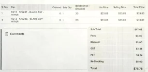

Just replaced our front wiper blades on our 2025. Price was $34 CAD a piece plus tax. OEM parts exactly like originals. They had started to chatter after 9 months of use and around 10K km.
