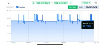

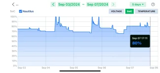

Mid May purchase of hybrid and had no issues until car went into Deep Sleep mode while at detailer mid June. Since then, my major issue has been when the battery gets low the door entry switches will not recognize the Key Fobs (must unlock with the fob to enter). We drive mostly short trips weekly with a 2 hour round trip once or twice a week. I purchased and installed a NOCO Genius 10 maintainer and an Antigravity Battery Tracker +Plus. I have typically had to put the NOCO on once a week when the battery was getting low just to be safe. About 2 weeks ago, it all of the sudden again wouldn't recognize the Key Fobs. For the past 5 days, I have not put it on the maintainer to see what it would do (see attached graphs) I am surprised that the battery is staying up. All the upward spikes are when the car is being driven.
That said, I have a service appointment next week for the following; "Fix the door switch/fob problem (for the 2nd time), perform open bulletins; 24P08 and/or 24P08B (CRM software), 24C24 (window safety), 24P22 and/or 24P22B (ABS update), 24P07 (rear shocks) and any other DTCs as required." Bulletins 24B23 (injectors) and 24P14 (VDM update) were done mid July I may also request that the 12 volt battery is replaced. I just have a feeling that that initial Deep Sleep really impacted its life.Nautilus Hybrid Voltage 5 Day.webpNautilus Hybrid SOC 5 Day.webp
@Starfish
Most AGM Battery charge charts list 100% around 12.7 to 13.0 V. Your charts look like how I expect a healthy battery to work. Voltages higher than 13V indicate charging. How long are your drives?
