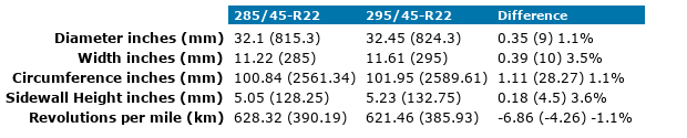

That issue aside, these trucks always have bad manners over local bumps and I think the issue is the lack of amount of sidewall on the 22" factory tires. I am contemplating changing the standard 285/45/22 to 295/45/22 with Micheline. Has anyone else done so or looked into it? It seems the change would provide taller side wall, wider stance, and minimal calc difference affecting the odometer and other systems. Please let me know and ill continue to update any further developments I come across.
If you do a tire size change, a rather inexpensive service tool, such as the Autel MX900 will be able to adjust the tire size in the ECU to correct for the change. It is a simple change the dealership can make as well, and would be simple for you to verify with a tool (if you like to do that).
