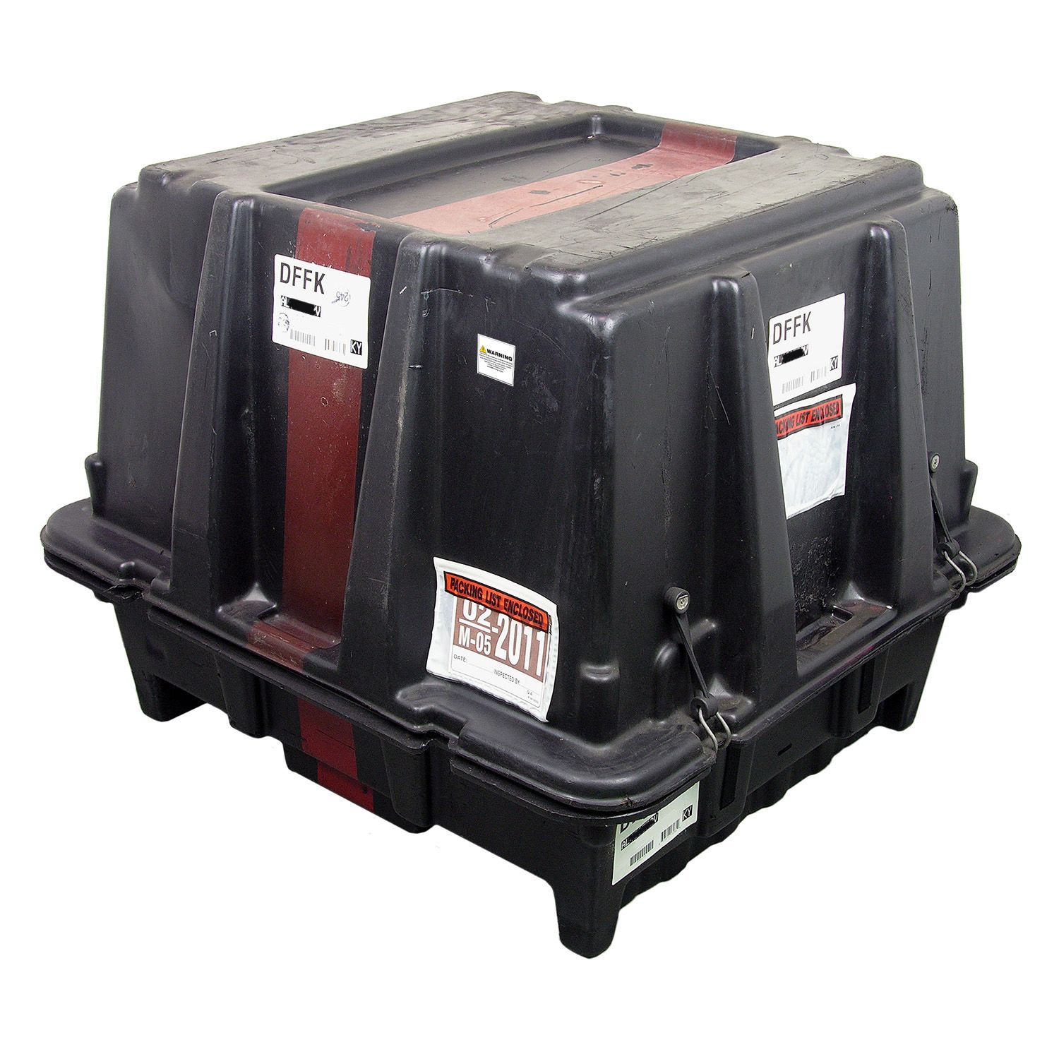

I found that motor for a little under 5k and I'm thinking labor at the most should be another 1.2k to 3k. Give or take. I have a mechanic that will work with me as long as I buy the parts he'll work with me on labor. But the reason I wont mind spending so much on this car. Its a really nice car and I can pass it down to my nephew in a few years. So it'll be well worth it.
BTW that link above is NOT a Coyote engine as stated in post #20. Not even close
As you stated a Coyote engine starts at $10K and goes up fast from there.
After tax, options to get the remanufactured engine delivered and miscellaneous pieces, you will be at the $10K mark.
Without a transmission.
