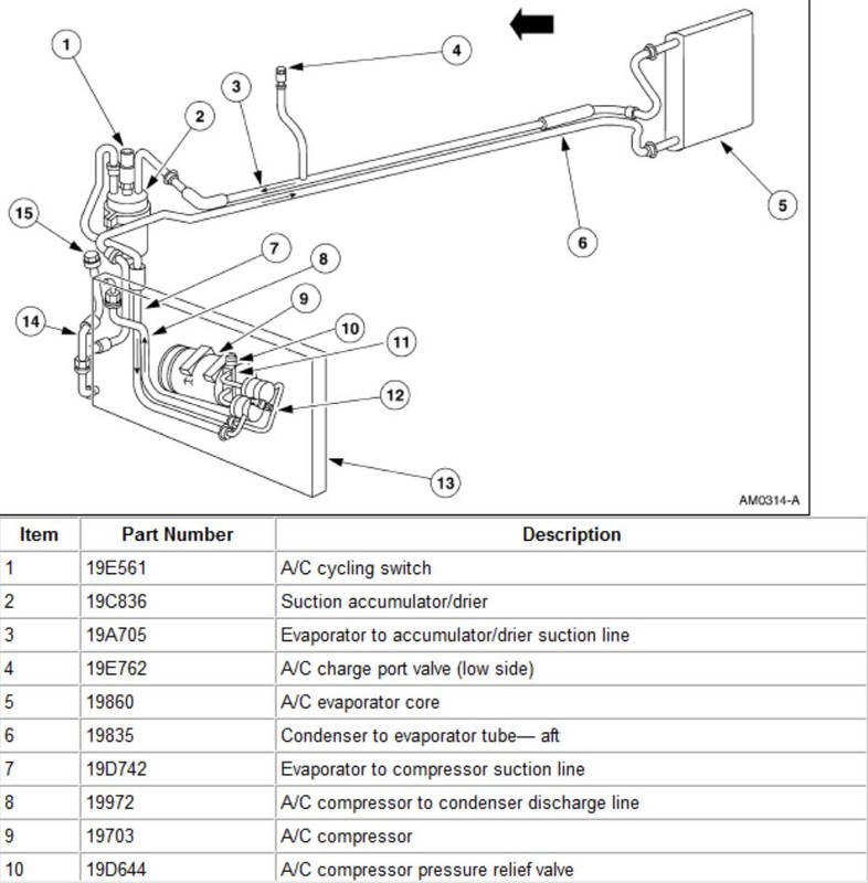

Everything on these FWD Continentals is packed in like a can of sardines.
On the 2002 it is on the right side up front in the the air compressor area.
Make sure you take the full width plastic fan cover off first.
From the 2002 service manual:--
See #2.

Thank you for the photo. The link is dead. I see an air pump or whatever it is in the corner, but no accumulator. I think the thing in the corner is an air compressor for the suspension.
If you expand the pic I posted there is a numbered list of the parts in the drawing.
#2 is the accumulator/drier. #9 is the A/C Compressor.
This drawing from the '02 service manual shows the components of the AIR CONDITIONING SYSTEM.
It does not reference or show the compressor for the air suspension.
I suggest you take your car to an experienced mechanic that knows what he is looking at.

#9 is the A/C compressor. The thing I was speaking about is the suspension compressor, which is just in front of the accumulator. I haven't pulled the full length plastic radiator cover off yet, but in that corner of your photo where it shows the accumulator is the suspension compressor. This is why there is confusion. I have the a/c accumulator (as well as the compressor), but it is metal and somewhat large, whereas the suspension compressor is right where the photo shows the accumulator.. This is why there is confusion. Visible to me in that corner is a plastic compressor, which IS the suspension compressor. The metal accumulator must be hidden underneath it because it is far too large (yes I purchased the correct one) for the area. I can see the a/c lines, but hopefully when it gets a little warmer out, I will take my Corvette convertible of the lift and put the yacht up there to see if I can see it from below. If you look at my photo in the original photo, you can see just in front of the diagonal bar is the suspension compressor next to the windshield washer fill cap. You cannot see the accumulator anywhere from that photo
