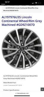

Pricing around, the OEM 18” wheels I’m interested in (photo below) from the Ford parts website are about $300 each. I’ll call my local dealer again to see if I get someone different this time lol.
This was the standard 18"wheel available for 2017 models. Similar to the Ford you found.
