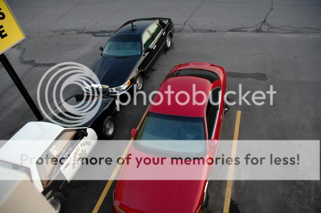

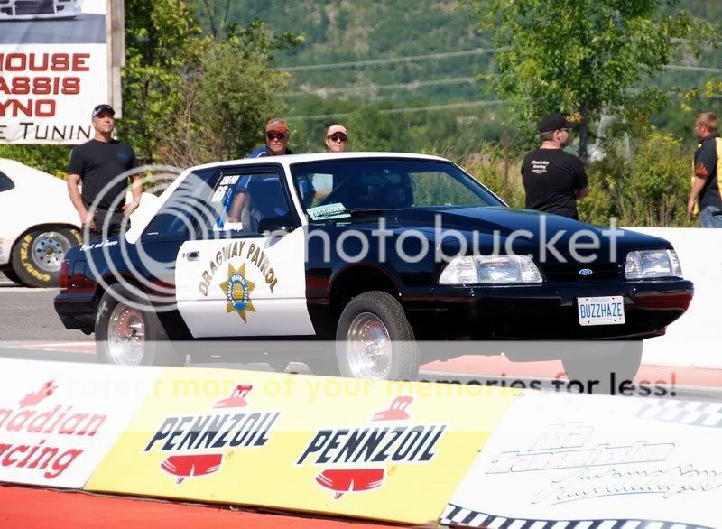

Thanks for any advice and I look forward to reading more. Here's a shot of my current cars. Yes, the Mustang is plated and insured for the street but it's a drag car. No, I'm not a cop haha

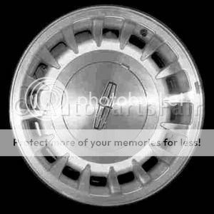

I live over a Benson's Autoparts shop in the west end and they can get wheels but I kind of like the 16 tooth wheels that came with the Towncar, except for the fact they are beat up, I like the style and look so I was hoping to scour the junkyards for a set that are still in nice shape, if not, then I guess a set of aftermarket rims will do the trick. I like the 7 star pony-style rims you have on yours for winter but I am going for more of a stock look for this Lincoln.
Based on your excellent information, I might just stick with the 16" since it won't require spacers or anything. I'll start searching for a better set of 16 tooth like these:
I do like these stock Lincoln rims as well but I think they are bigger than 16"....that's why I was hoping they would fit.

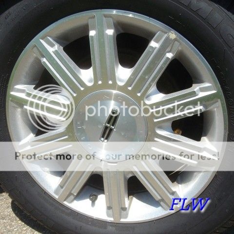

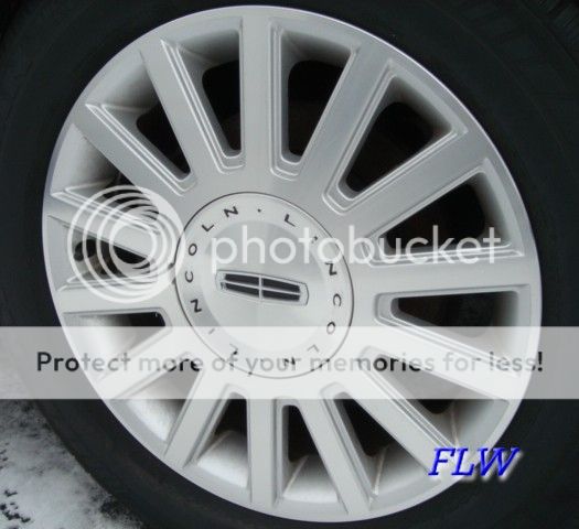

You can get alloy wheels refurbished. I use CAPS for aftermarket parts and I think they have a supplier to refurbish wheels. Their store in the West end is at 28 Capital Dr and their phone # is 613-727-0300. The 3 lower pictures are of the 2003 and up 17" wheels for the Town Car, which are not a direct fit for your car. The Ford wheels from a dealer are usually in the $500 range each. You will want to ask Campbell Ford for their aftermarket direct fit wheel package, usually sold with winter tires, but should be available separately.
