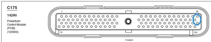

I've currently dealing with some weird issues with my 2003. The car will run perfect then all of a sudden, it stops running on 3 cylinders. I get the EXACT same codes everytime. P0351, P0353, and P0357. I know these are connections issues and not misfires. The problem doesnt seem to happen in park or neutral. Seems to happen most often while in drive or reverse, and stopped at a light or stop sign. Doesnt typically happen if im moving. it will last for 10 seconds to a minute, then clear up until i come to a stop again. After i clear codes, i will get the exact codes when it happens again. P0351, P0353, and P0357.
Ive replaced all the Plugs with Motorcraft. Ive replaced all COP's with motorcraft. I've swapped COPs around... its doesnt matter.. same codes. P0351, P0353, and P0357. I've soldered new COP connectors for all 8 COPs. That didnt fix the issue. Im at the end of my rope here. Any other suggestions before i try swapping the pcm? Whatever the problem is, it's only affecting those cylinders AND it's affecting all 3 at the exact same time.
