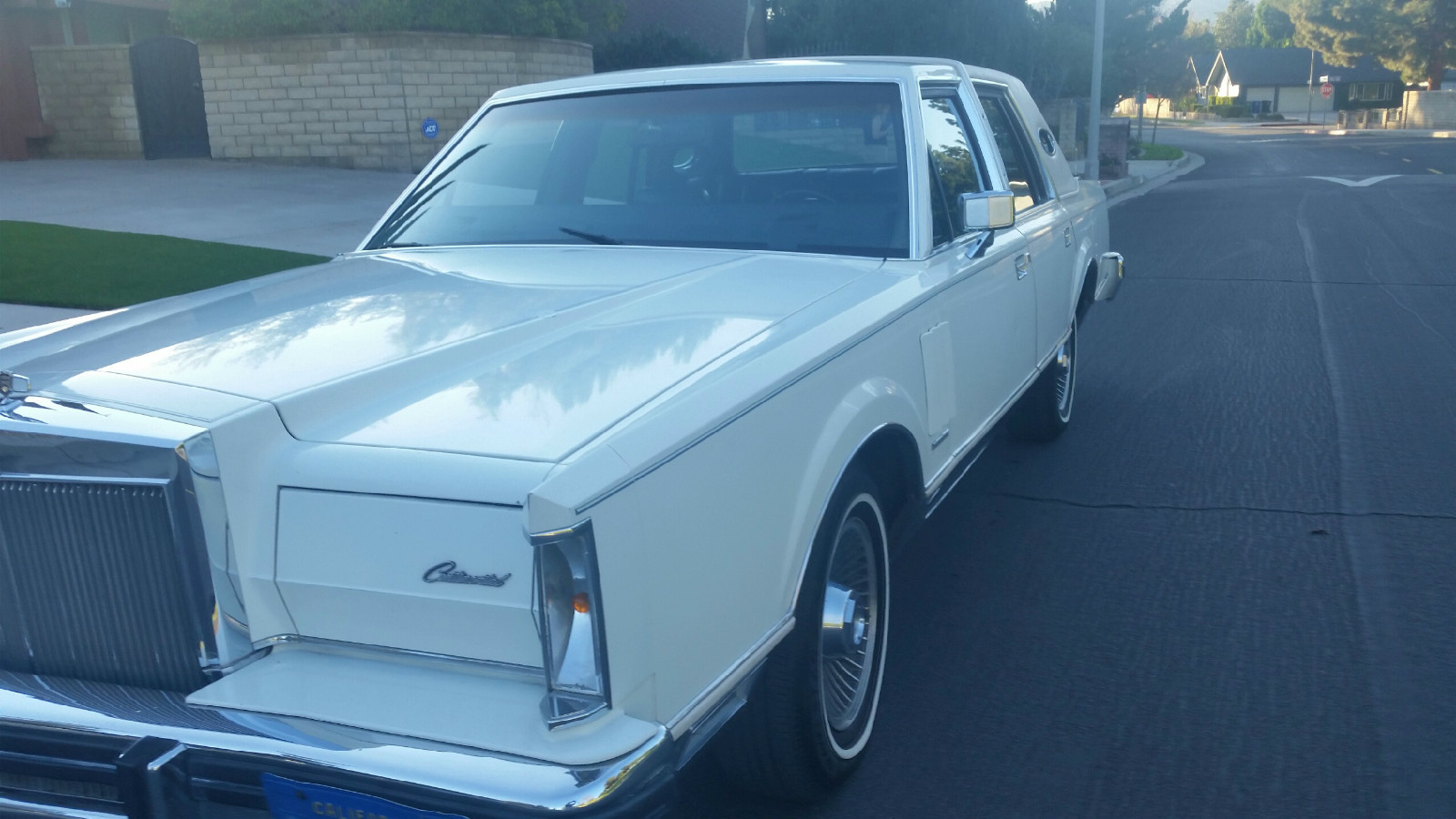

Today I fell for purchasing a 4 door 1981 Mark VI, and will be greatly appreciative if my questions could be answered. wondering:
1) What purpose do the flairs in the front fenders serve?
- if none, would they be interchangeable between the 1981 Mark VI and 82-89 Town Car to remove the flairs?

Nice looking Mark VI. I have a 4 door 1983 Continental Signature Series with all the options. A lot of parts can still be found online. This model is the Panther platform. Some parts, such as your broken turn signal lense, can be found on E-bay. There was one listed a few days ago for about $100 to $150.00 US. As for as interchangability goes, some are and some are not. It would be best to check on-line with a Lincoln dealer in the U.S.A., to see what is available and what is interchangable. Some things are getting hard to find.
1) The flairs serve no functional purpose. Supposedly they do allow some venting of the engine compartment, but it would be insubstantial. Any fender panel from an '80-84 Town Car would work in its place--I've actually seen a car like this before--but you'd have to match/blend paint of course. Probably the '85-89 Town Car would be interchangeable, too, since it was just the front and rear lamp housing panels that were restyled and not the sheetmetal. Somebody would have to confirm that.
