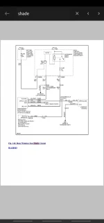

Hello,
I have 2018 black label and , i fear of this damage for rear sunshade , i got the service manual for it but cannot find where to cut the reverse gear supply? And it will affect any thing else?
If any one can help , I attached the diagram

My kids were in the back seat pushing as many buttons as they could see and curated the “sunscreen clicking”. I found that fuse#23 on the inside fuse panel is for the rear sunscreen; however it also supplies other things so you cannot simple pull the fuse. The cover panel in the trunk under the rear sunscreen is held in place with 4 of those push-in tabs. Remove these 4 tabs and wiggle the panel out to expose the sunscreen motor. I just disconnected the wires to the motor and the terrible clicking noise was gone, but so was the powered screen. I only remember using it once or twice so I don’t think I will miss it.
