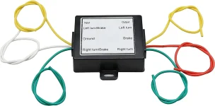

There are conversion boxes available. Search for "2 to 3 trailer light converter" or similar.
WARNING :
There are a LOT of 3 to 2 converters for connecting single bulb trailers to cars with yellow turn signals. 3 to 2 is NOT what you want. You need 2 to 3. The one you want is made for flat towing a car with yellow turn signals behind an RV with all red rear lights.
Of course you still need to have the remaining red bulb on the blinking side come on as a brake light. I would think you could take the original wire for each side to feed the converter (but not any lights) and then feed the red and yellow bulbs from the converter output.
The LCM will likely complain about the lack of load (it will think the rear bulbs are burned out) so some additional load will likely need to be added to the original wires at the converter input.
I've seen some complaints about how well the 2 to 3 converters actually work so do some investigating before you choose one.
Thank you, this sounds like an interesting option. Something like this? https://www.amazon.com/dp/B07Z5Z8BZ7/
//edit: I added a picture for anybody seeing this thread later (and if the Amazon link disappears).
Jens, yes, that is the type of converter I meant.
