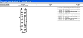

I'd lean toward a stuck output on the LCM. You could unplug C2145C from the LCM to see if the issue is there or further downstream.
Wiring Diagram and C2145C drawing attached...
