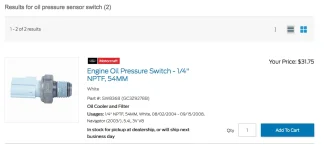

Is this the new part? Screen Shot 2024-02-13 at 6.10.59 PM - Ford Oil Pressure switch.webpbecause if so I'm pretty sure this is what I saw.
Is this the new part? View attachment 20109because if so I'm pretty sure this is what I saw.
That is the new oil pressure switch for your modular engine. Should be very close to the oil filter.
Or oil filter mounting.
This is a picture of a OE oil filter adapter with the pressure sensor.
Taken from an eBay listing that states it fits 2003 to 2008 Navigator with 5.4l engine.
The orientation of the picture may not be the same as on the engine.
(You would not want to wait for me to snap a pic of mine)
And there is an oil level sensor in the oil pan.

Thanks, I feel like I can replace that myself. I have an appt. with a mechanic tomorrow to check the oil pressure with a pressure gauge and give me more data. He told me it was mostly likely not the sensor (based on my story of how the light comes on more quickly and stays on longer if I keep driving it...and not the oil pump (because he has almost never seen that)...and instead said it is usually the bearings going bad and losing tolerances. I guess I will know more tomorrow...
