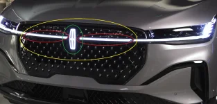

I have a 2024 Nautilus Premiere II Hybrid Eq. Group 102A. I absolutely love it, and the various upgrades that were included in the 102A, but if I had one complaint, it's that it doesn't have the full Lincoln Embrace lighting or the lighted emblem that come on the Reserve and Black Label.
Question: Does anyone have technical information on whether the parking light bars (red) and lighted emblem (green) in the picture attached can be upgraded, and what may be entailed (such as additional required components)?

If someone with the feature could look at how it is connected, we could find out. The question is if the light bar is an integral part of front grille or fastened. The parts should be available since likely a common part replaced in the crash. The main wiring harness is likely common to all in the front but the specific connections are just unused.
I saw the center emblem is available on parts.ford.com and there appears to be a wiring harness jumper to connect to it. It is hard to tell about the light bar though.
I've done a little research and have confirmed that:
1) The DRL Side Marker Lamp parking light bars are fastened to the front grille and can be replaced, however
2) The DRL Side Marker Lamp parking light bars do require a different headlamp assembly than what is on the Premiere on both sides that includes an additional connector that the light bars connect to. This additional connector enters the headlamp assembly from the bottom of the assembly that appears to be a removable cap for the standard version that does not include the additional connector. It does not appear that the DRL connector can be purchased as a separate component.
3) The headlamp assembly's main connector includes the same eight pins for both headlamp assembly versions, and the wire harness includes eight wires in for the Premiere and the Reserve/Black Label.

It seems that since the light bar connects directly to the headlamp assembly, and that both the higher level headlamps and lower level headlamp assemblies have all the same pins. you could likely bypass the headlamp assembly altogether and just tap the light bars directly into the main connector instead.
