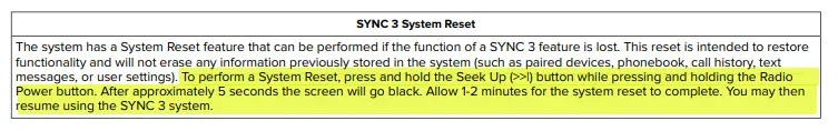

The issue:
Frequently, the navigation app will display an icon that reads GPS with a circle around it and a line through it. And of course navigation no longer works. (See attachment)
Additionally, in progress phone calls will drop.
The temporary fix for the GPS issue is to pull over, stop the engine, start the engine and then perform a warm reset. (See attachment)
Once done, things work for a while but then repeat themselves.
The service bulletin I found was 20-2255. (but there probably is a newer number by now.)
My Lincoln Dealership has not been able to replicate the issue when the MKC has been in for service. (I'm unsure how hard they really tried.)
Their latest suggestion is that I pay $1555.00 to replace the Sync3 Accessory Interface Protocol Module.
But of course if it doesn't fix the issue, I'm out the $1555.00. (I guess that's how most Dealerships work isn't it ?)
I was thinking maybe the service bulletin, when applied, might fix the issue.
So, I was trying to see if I could see if it had already been applied to my MKC.

Is your sync up to date? I've also read doing a reset on the AIPM with forscan can correct a lot of issues, but I have no personal experience with that.
